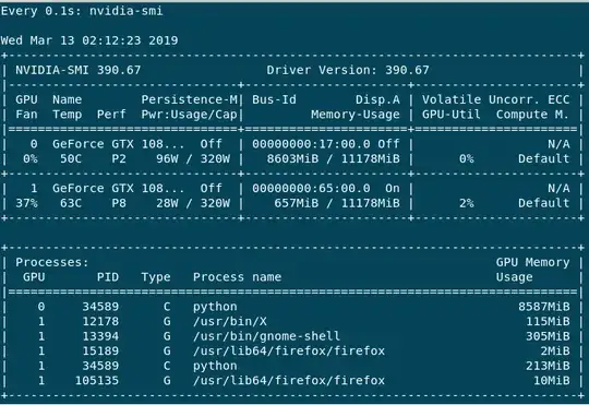

The training is very slow which I understand is down to the batch size (correct me if I am wrong). If I do help -n 1 nvidia-smi, I get the following output:
The GPU:0 is mainly used, as the Volatile GPU-Util gives me around 0%-65% whereas GPU:1 is always 0%-3% max. Performance for GPU:0 is always in P2 whereas GPU:1 is mostly P8 or sometimes P2. I have the following questions.
  1. Why I am getting an OOM error on the large batch size although my dataset and model are not that big?
  2. How can I utilize both GPUs equally in TensorFlow so that the performance is fast? (From the above error, it looks like GPU:0 gets full immediately whereas GPU:1 is not fully utilized. It is my understanding only).

  1. Why I am getting OOM error on the large batch size although my dataset and model are not that big?
Yes, the batch size is probably the reason.
Also, another the reason is that you don't use the second GPU at all (otherwise, both GPUs will split the batch - computation - and you could use larger batches).
  1. How can I utilize both GPU's equally in Tensorflow so that the performance is fast? (From the above error, it looks like GPU:0 gets full immediately whereas GPU:1 is not fully utilized. it's my understanding only)
By default, Tensorflow occupies all available GPUs (that's way you see it with nvidia-smi - you have a process 34589 which took both GPUs), but, unless you specify in the code to actually use multi GPUs, it will use only one by default.
Here is an official TF docs about how to use multi GPUs: https://www.tensorflow.org/guide/using_gpu#using_multiple_gpus https://www.tensorflow.org/guide/gpu#using_multiple_gpus
