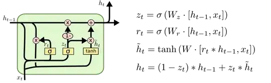

Just as a reminder, here is what LSTM looks like at each timestep, taken from this blog: enter image description here
