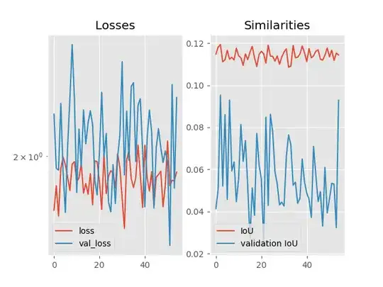

I've tried using dozens of different loss and accuracy functions found here and there on the web, mainly variants of pixel-wise cross-entropy and soft dice loss, as well as tweaking the learning rate from $10^{-1}$ to $10^{-5}$ (the authors used $10^{-2}$ in the original paper), and every time I get the same; the loss value basically oscillates around a fairly small value and then the early stopping callback I'm using stops the training phase after $7$ or $8$ epochs.
Here's the evolution of a typical metric if I don't stop the process (in this case the learning rate was set to $10^{-5}$, batch size of $10$):

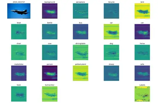

I decided to make a prediction on the same image after each epoch and here's what it looks like after the first epoch (bottom right "labels" a picture is just the argmax on the feature maps):
And after 20 epochs:
All intermediary results look something like, apparently independently from the hyperparameters.
