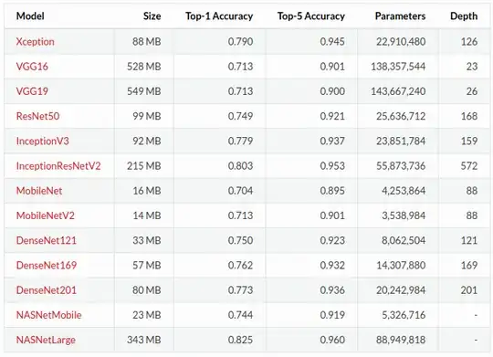

Having listed a few factors in the final inference time required (time taken to produce one forward run through the network), I would guess that MobileNetV2 is probably among the fastest pre-trained model (available in Keras). We can see from the following table that this network has a small memory footprint of only 14 megabytes with ~3.5 million parameters. Compare that to your VGG test, with its ~138 million... 40 times more! In addition, the main workhorse layer of MobileNetV2 is a conv layer - they are essentially clever and smaller versions of residual networks.
Keras pre-trained models
Extra considerations
The reason I included the whole table above was to highlight that with small memory footprints and fast inference times, comes a cost: low accuracies!
If you compute the ratios of top-5 accuracy versus number of parameters (and generally versus memory), you might find a nice balance between inference time and performance.
