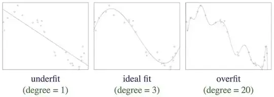

  • Low capacity models (e.g. linear regression), might miss relevant relations between the features and targets, causing them to have high bias. This is evident in the left figure above.
  • On the other hand, high capacity models (e.g. high-degree polynomial regression, neural networks with many parameters) might model some of the noise, along with any relevant relations in the training set, causing them to have high variance, as seen in the right figure above.

Yes. Likewise a model can have both high bias and high variance, as is illustrated in the figure below.
