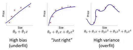

One way to detect such situation is to use the bias–variance approach, which can represented like this:
Your model is underfitted when you have a high bias.

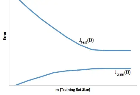

High bias: This learning curve shows high error on both the training and test sets, so the algorithm is suffering from high bias:

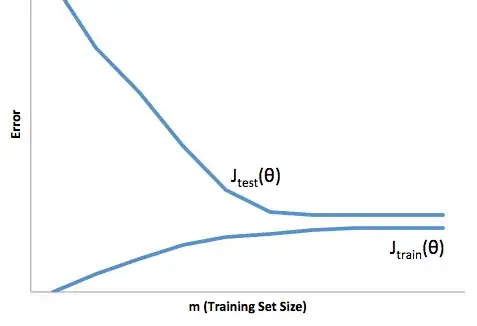

High variance: This learning curve shows a large gap between training and test set errors, so the algorithm is suffering from high variance.
If an algorithm is suffering from high variance:
  • more data will probably help
  • otherwise reduce the model complexity
If an algorithm is suffering from high bias:
  • increase the model complexity
I would advise to watch Coursera' Machine Learning course, section "10: Advice for applying Machine Learning", from which I took the above graphs.
