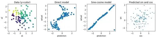

You can go on and plot the predictions, to see that predictions of the sine-cosine model are nearly correct, although may need some further calibration:
plt.figure(figsize=(12, 3))
plt.subplot(1,4,1)
plt.scatter(X[:,0], X[:,1], c=y)
plt.title('Data (y=color)'); plt.xlabel('x1'); plt.ylabel('x2')
plt.subplot(1,4,2)
plt.scatter(y_simple_pred, y)
plt.title('Direct model'); plt.xlabel('prediction'); plt.ylabel('actual')
plt.subplot(1,4,3)
plt.scatter(y_trig_pred, y)
plt.title('Sine-cosine model'); plt.xlabel('prediction'); plt.ylabel('actual')
plt.subplot(1,4,4)
plt.scatter(joint[:,0], joint[:,1], s=5)
plt.title('Predicted sin and cos'); plt.xlabel('cos'); plt.ylabel('sin')
plt.tight_layout()
