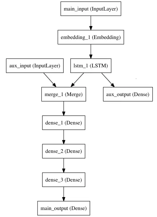

From the same question you mentioned, you will find an interesting link to Keras documentation. If you navigate to Multi-input and multi-output models you'll find an example code that does exactly this.

See . Multiple Input and Output Models
https://machinelearningmastery.com/keras-functional-api-deep-learning/
