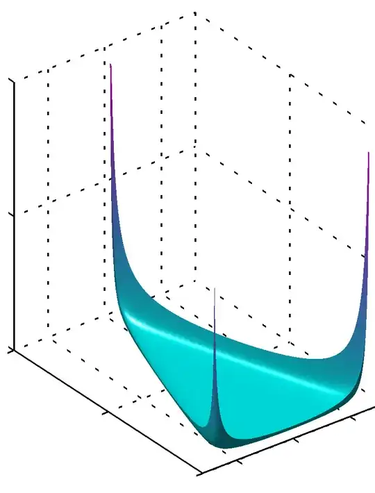

If all the $\alpha_k$ have values lower than unit the maximum is found at corners

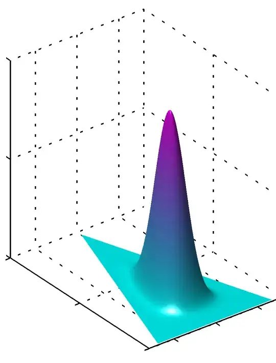

or can if all values $\alpha_k$ are the same and greater than 1 the maximum will be found in center like
