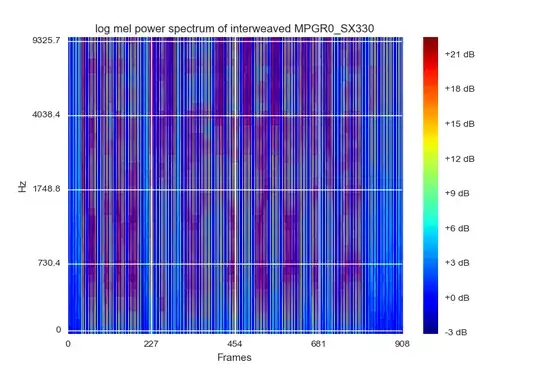

The visualisation of log mel filter banks is a way representing and normalizing the data. They suggest to visualize as a spectogram with RGB colors, which the closest I could come up with would be to plot it using matplotlibs colormap cm.jet. They (being the paper) also suggest each frame should be stacked with its [static delta delta_delta] filterbank energies. This looks like this:

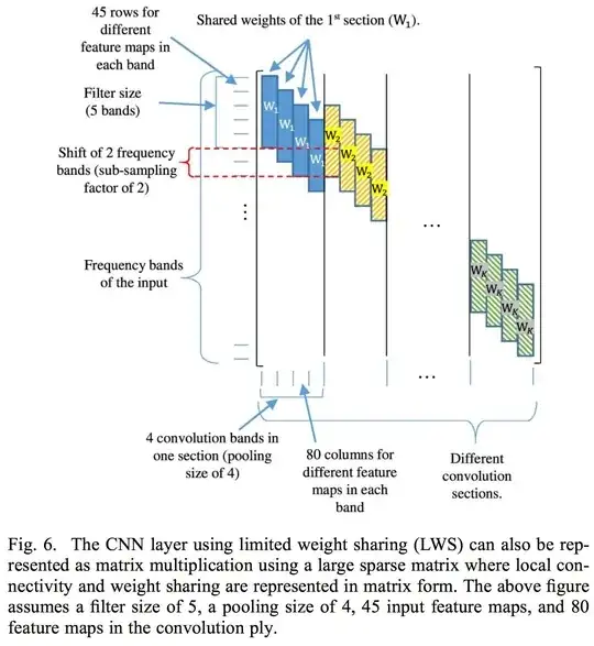

The limited weight sharing consist of limiting the weight sharing to a specific filter bank area, as speech is interpreted differently in different frequency area, thus will a full weight sharing as normal convolution apply, would not work.
Their implementation of limited weight sharing consist of controlling the weights in the weight matrix associated with each convolutional layer. So they apply a convolution on the complete input. The paper only applies only one convolutional layer as using multiple would destroy the locality of the feature maps extracted from the convolutional layer. The reason why they use filter bank energies rather than the normal MFCC coefficient is because DCT destroys the locality of the filter banks energies.

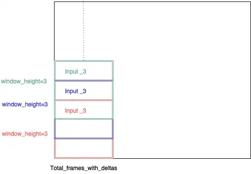

Instead of controlling the weight matrix associated with convolution layer, I choose to implement the CNN with multiple inputs. so each input consist of a (small filter bank range, total_frames_with_deltas, 3). So for instance the paper state that a filter size of 8 should be good, so I decided a filter bank range of 8. So each small image patch is of size (8,45,3). Each of the small image patch is extracted with a sliding window of with a stride of 1 - so there is a lot of overlap between each input - and each input has its own convolutional layer.
(input_3 , input_3, input3, should have been input_1, input_2, input_3 ...)

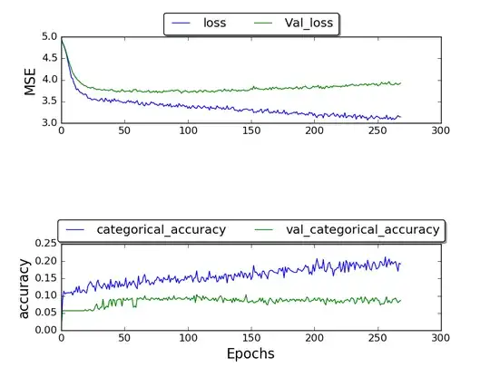

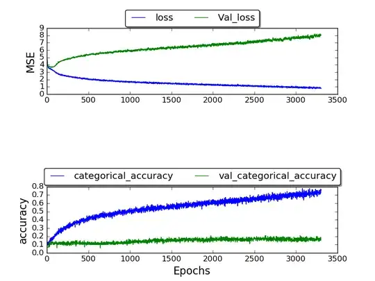

I been training the network and have only been able to get a validation_accuracy of highest being 0.17, and the accuracy after a lot of epochs end up being 1.0. enter image description here (Plot is currently being made)
fixed frame:
enter image description here (plot being still made)
I am not sure why I am not getting better results.. Why this high error rate? I am using the TIMIT dataset which the other ones also use.. so why am I getting worse results?
