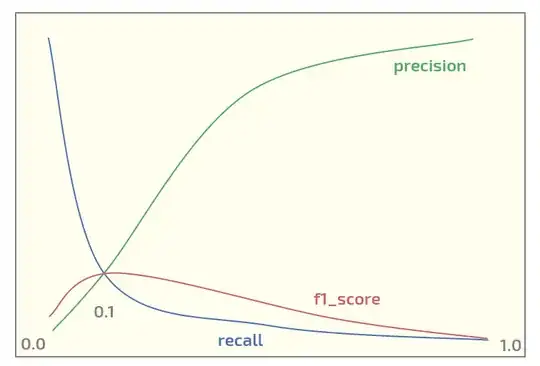

Now, on the initial dataset I am getting the following plot (threshold at x-axis):
Having maximum of f1_score at threshold = 0.1. Now I have two questions:
  • should I even use f1_score for a dataset of such a structure?
  • is it always reasonable to use 0.5 threshold for mapping probabilities to labels when using XGBoost for binary classification?

You have to decide what you want to maximize.
Classifying by comparing the probability to 0.5 is appropriate if you want to maximize accuracy. It's not appropriate if you want to maximize the f1 metric.
If you want to maximize accuracy, always predicting zero is the optimal classifier.
Alternatively, given a probability score $p$, another option is to randomly flip a biased coin; with probability $p$, output classification 1, otherwise output classification 0. This doesn't always predict zero. However it's probably not actually any better in any useful way.
If you want to maximize f1 metric, one approach is to train your classifier to predict a probability, then choose a threshold that maximizes the f1 score. The threshold probably won't be 0.5.
Another option is to understand the cost of type I errors vs type II errors, and then assign class weights accordingly.
