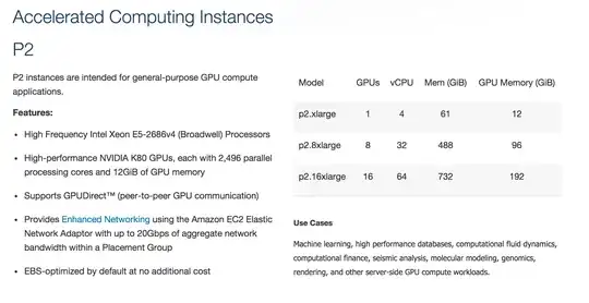

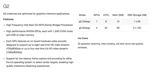

I have discovered that Amazon has a dedicated Deep Learning AMI with TensorFlow, Keras etc. preinstalled (not to mention other prebuilt custom AMIs). I tried out this with a typical job on several GPU-based instances to see the performances. There are five such in the Ireland region (maybe in other regions exist even more, I don't know, this variance is a bit confusing):
  • g2.2xlarge
  • g2.8xlarge
  • p2.xlarge
  • p2.8xlarge
  • p2.16xlarge
My first question is, what is the difference between the two groups (g-something and p-something)? Both group mentions "GPUs along with CPU", but no further clue for Deep Learning usability.

I think the differences and use cases are well pointed here. As far the workload, there are features which help you optimise it. According to the official documentation, you can try:
