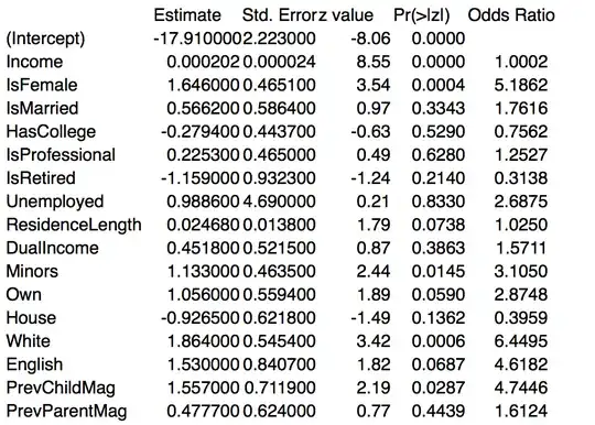

In both logistic regression and least-squares regression, the regression coefficient table will include a column for the regression coefficients followed by a column of standard errors, then by a column of test statistics, and finally a column of p-values. The table below shows the example coefficient table output for the some regression problem (where the probability of buying some magazine for kids is estimated). example problem coefficients table
Note that the test statistics are labeled “z value” and the p-values are labeled “P(>|t|)” in the table above. The standard errors can be used to construct confidence intervals for the regression coefficients. Roughly speaking, going plus or minus 2 times the standard error from the regression coefficient gives approximately a 95% confidence interval for the coefficient.
For example, for Residence Length, the regression coefficient is 0.024680. The next column gives the standard error of the regression coefficient which is 0.013800. Thus an approximate 95% confidence interval for the Residence Length regression coefficient is:
$$ 0.024680 \pm 2 \times 0.013800 = 0.024680 \pm 0.0276\ $$
This means that the regression coefficient for Residence Length could be anywhere from -0.00292 to 0.05228 (with 95% confidence).
As is well known, we often use the odds-ratio, which is the exponential of the regression coefficient (i.e., $\exp(\beta)$ ), to help to interpret the meaning of the regression coefficient. The odds-ratio for the Residence Length coefficient, as shown in the coefficient table, is 1.0250. This means that there is a 2.5% increase in the odds of buying the magazine associated with each additional year of residence.
We can also compute the odds-ratios corresponding to the ends of the confidence interval. These odds-ratios will give us an equivalent confidence intervals for the odds. So continuing the example using Residence Length, the odds ratios corresponding to the ends of the confidence interval are
$$ \exp(-0.00292)=0.99708 $$ and $$ \exp(0.05228)=1.05367. $$ Thus, the interval [0.99708,1.05367] is an approximate 95% confidence interval for the odds ratio. This means that there could be anywhere from a 0.292% decrease to a 5.367% increase in the odds of buying the magazine associated with each additional year of residence.
