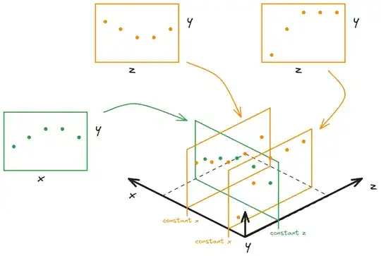

Probably you can visualize your data like this and then use bilinear interpolation to extend it at every point of the x-z grid.
