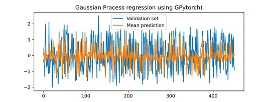

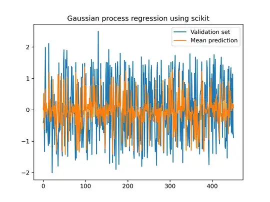

This is a MWE of my problem, basically I want to find out the map between qin and qout using a Gaussian process and with that model trained, test the prediction of some validation data qvalin against qvalout.
tensors.pt: https://drive.google.com/file/d/1LwYgEGqRRBPurIh8Vrb7f_lK-C9q0eQ_/view?usp=drive_link
I have left all default hyperparameters, except the learning rate. I haven't been able to lower the error below 92 % for either GPytorch or scikit-learn. I did some optimization but couldn't find a good combination of hyperparameters. Is there anything I am not doing correctly?

# Scikit
t1 = time.time()
kernel = 1 * RBF(length_scale=1.0, length_scale_bounds=(1e-2, 1e2))
gaussian_process = GaussianProcessRegressor(kernel=kernel, n_restarts_optimizer=9)
gaussian_process.fit(qin, qout)
gaussian_process.kernel_
mean_prediction, std_prediction = gaussian_process.predict(qvalin, return_std=True)
print('Optimization time: {}'.format(time.time() - t1))
plt.plot(qvalout, label=r"Validation set", )
plt.plot(mean_prediction, label="Mean prediction")
print(f'´Norm of diff: {100*np.linalg.norm(mean_prediction - qvalout.numpy()) / np.linalg.norm(qvalout)}%')
plt.legend()
_ = plt.title("Gaussian process regression using scikit")
plt.savefig('scikit_.png', dpi=300)
plt.show()
# GPytorch
num_tasks = 1
likelihood = gpytorch.likelihoods.MultitaskGaussianLikelihood(num_tasks)
model = MultitaskGPModel(qin, qout, likelihood)
model.train()
likelihood.train()
opt = torch.optim.Adam(model.parameters(), lr=1, betas=(0.9, 0.999),weight_decay=0)
mll = gpytorch.mlls.ExactMarginalLogLikelihood(likelihood, model)
training_iter = 20
scheduler = optim.lr_scheduler.ReduceLROnPlateau(opt, mode='min', factor=0.5, patience=100, verbose=True)
for i in range(training_iter):
    opt.zero_grad()
    output = model(qin)
    loss = -mll(output, qout)
    loss.backward()
    print('Iter %d/%d - Loss: %.3f' % (i + 1, training_iter, loss.item()))
    opt.step()
model.eval()
likelihood.eval()
f, (y1_ax) = plt.subplots(1, 1, figsize=(8, 3))
with torch.no_grad(), gpytorch.settings.fast_pred_var():
    test_x = qvalin
    test_x_out = qvalout
    predictions = likelihood(model(test_x))
    mean = predictions.mean
    lower, upper = predictions.confidence_region()
y1_ax.plot(test_x_out.numpy(), label='Validation set')
y1_ax.plot(mean.numpy(), label='Mean prediction')
plt.legend()
print(f'Norm of diff: {100 * np.linalg.norm(mean.numpy() - test_x_out.numpy()) / np.linalg.norm(test_x_out.numpy())}%')
y1_ax.set_title('Gaussian Process regression using GPytorch)')
plt.savefig('gpytorch_.png', dpi=300)
plt.show()
if name == "main": main()
