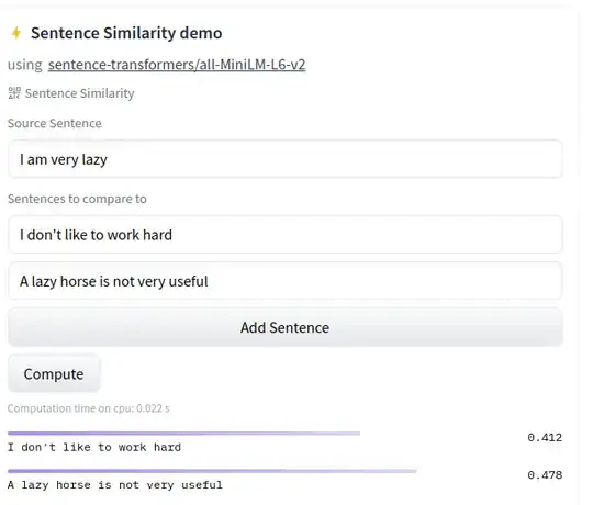

I am looking for the correct model / approach for the task of checking if two sentences have the same meaning
I know I can use embeddings to check similarity, but that is not what I am after. I suspect BERT style LLM have nice higher level vector that mights be useful, but I'm not sure how to apply that.
For example this sentence:
  • I am very lazy
Has a somewhat similar meaning as:
  • I don't like to work hard
But not
  • A lazy horse is not very useful
Using 'just' embeddings (for example HF: allMiniLM-L6-v2) gives results that are not useful.
What would be a good appoarch?
The similarity used to train this model might be different from the similarity you expect.
A better approach would be create your own large and good quality training set of similar and dissimilar sentences and fine-tune a pretrained model (the one from your question or some other) using the same sentence transformers library (https://www.sbert.net).
Another currently available alternative is to play with prompts for the huge commercial models (ChatGPT, GPT-4, Google Bard, etc) and hopefully they can understand what you want and do the task for you without any additional effort. For example ChatGPT said sentence B is more similar to A in 10/10 retries in my test.
