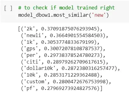

-- to check if model trained right
model_dbow1.most_similar('senseless')
Error:
KeyError: "word 'senseless' not in vocabulary"
The data I have given to model for training as input has the word "senseless" so why this error? Could anyone please help?Other word is giving output
This is Doc2Vec not Word2Vec, so I don't think you you don't give a word to most_similar(). So instead of:
I think you would do:
model_dbow1.most_similar('55001')
Or, alternatively if you did want to search for a one-word sentence:
vector = model_dbow1.infer_vector(["senseless"])
model_dbow1.most_similar([vector])
(The above is a bit of guesswork, based on the online docs for Doc2Vec, and some tutorials (e.g. this and e.g. Sentence similarity using Doc2vec). Where possible give a fully reproducible example that we can test against.)

The Doc2Vec API should be called this:
model_dbow1.wv.most_similar([vector])
Here is a complete working example:
from gensim.models.doc2vec import Doc2Vec, TaggedDocument
from nltk.tokenize import word_tokenize
from tqdm import tqdm
q_arr = " ".join(['senseless', 'movi', 'like', 'dilwal', 'happi', 'new', 'year', 'earn', 'easi', '100', 'crore', 'india']) cores = 4 train_documents1 = q_arr tagged_data1 = [TaggedDocument(words=word_tokenize(_d.lower()), tags=[str(i)]) for i, _d in enumerate(q_arr)] model_dbow1 = Doc2Vec(dm=1, vector_size=300, negative=5, workers=cores) model_dbow1.build_vocab([x for x in tqdm(tagged_data1)])
train_documents1 = utils.shuffle(tagged_data1)
train_documents1 = tagged_data1 model_dbow1.train(tagged_data1,total_examples=len(train_documents1), epochs=30)
vector = model_dbow1.infer_vector(["senseless"]) model_dbow1.wv.most_similar([vector])
