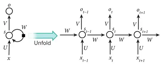

I'm using a basic RNN as in the figure below (say for translation). The model has the following structure:
\begin{aligned} s_t &= \tanh(Ux_t + Ws_{t-1}) \\ o_t &= \mathrm{softmax}(Vs_t) \end{aligned}
  • Assume that the vocabulary size is $m$ and that of the hidden layer is $n$.
  • If $x_{t}=\{0,1\}^{m}$ and U is a $ n \times m$ matrix then W is a $ n \times n $ matrix.
  • If $o_{t}$ is $\mathbb{R}^{k}$ and $s_{t}$ is $\mathbb{R}^{n}$then V is a $ k \times n $ matrix.
What are the # parameters for this RNN model?

The entities W , U and V are shared by all steps of the RNN and these are the only parameters in the model described in the figure. Hence number of parameters to be learnt while training = $dim(W)+ dim(V)+ dim(U)$.
Based on data in the question this = $ n^{2}+ kn + nm$.
where,
  • n - dimension of hidden layer
  • k - dimension of output layer
  • m - dimension of input layer

This is correct if one did not include biases. By including biases ($b_o$ and $b_h$). Number of parameters in $b_o$ is equal to number of outputs (k) and number of parameters in $b_h$ is equal to number of hidden layers (n). Hence the final value is:
$n^2 + n + mn + kn + k$
