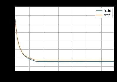

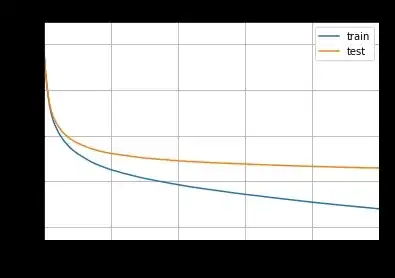

Here are the learning curves:
MAE evolution when optimizing RMSE MAE evolution when optimizing RMSE
MAE evolution when optimizing MAE MAE evolution when optimizing MAE

My guess would be that this is due to the differences between the two measures: compared to MAE, RMSE gives more importance to large errors because of the square. As a result a model optimized on RMSE has a strong incentive to correct its predictions when they are far off the true value, even if these cases are not frequent. By contrast a model optimized on MAE tends to favour obtaining the right prediction for as many instances as possible.
So my hypothesis would be that the model optimized on RMSE happens to find better parameters by trying to solve the large errors first, whereas the model optimized on MAE ends up in a state where it cannot improve on the few cases with large errors without sacrificing the many cases with small error. It should be possible to check by observing which instances the two models predict differently and by how much.
I would also note that the MAE-optimized model doesn't overfit as much as the RMSE one. So I'm not sure that the RMSE model is generally much better than the MAE one, given that the performance difference on the test set is not that high.
