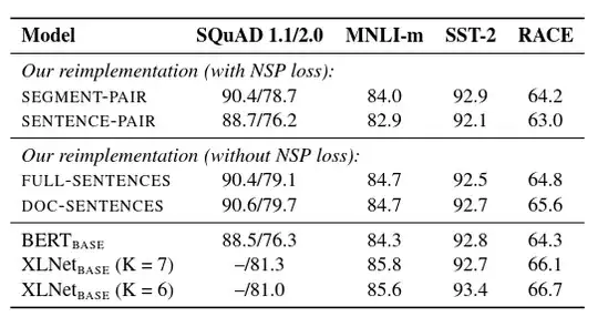

The motivation is that the [CLS] embedding should contain "a summary" of both sentences to be able to decide if they follow each other or not.
However, in follow-up papers such as RoBERTa or XLNet, only the masked LM objective is used and they reach better results than the original BERT.
Here is the table with with results from the RoBERTa paper (Table 2 on page 5) that specifically measures the effect of the next-sentence-prediction (NSP) loss.NS
