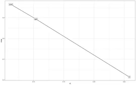

One interesting note, before proceeding:
The $RMSE$ and $R^2$ values for your problem have a strong negative correlation. Just look at this graph with the first three values:
Errors
The correlation coefficient is coming out to be -0.9999525 considering the first three models only. Now if, others are included, then also it stays the same.
Now coming to your answer, $R^2$ tells us about the % of variance that can be explained by the model. Whereas, $RMSE$ can tell us about how close our predictions were compared to the actual values. $RMSE$ often gives a better estimate about the model but it suffers badly when there are outliers in the prediction.
So, for that reason, I would suggest the following step before taking the final decision:
Compute the $MAD$ (Median absolute deviation) and $MAPE$ (Mean absolute percentage error) and see how are they coming. $MAPE$ also suffers if there are outliers in the model but we can get a better sense of the prediction as it takes the relative %.
In short: I would look at more Statistical Error Estimators before selecting the best model.
