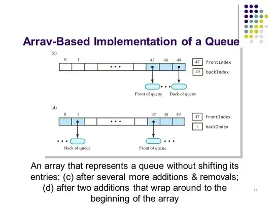

An example would be this:
Check this out.
