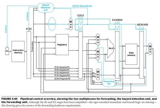

Typical educational material doesn't forward into the MEM stage, even though indeed it could do that, and may show a hazard detection unit (which makes the acronym MIPS a bit of a lie). For example from Patterson & Hennessy - Computer Organization and Design 4th edition (MIPS ver.):
Any load-use hazard is handled by inserting a bubble (the Hazard detection unit at the top does that), even lw into the data-operand of sw (we cannot forward into the address operand since it needs to go through the ALU), for which there could be a separate forwarding unit but there just isn't. In this case, the example code would have a bubble inserted between the load and the store.
