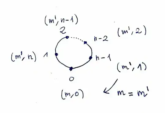

I have to post this answer since it is probably what I will implement in practice because it is more extendable to other settings and it can be well encoded in my system by logical formulas. However, I will still refer to D.W.'s approach since is mathematically more appealing and for me as a mathematician opens a lot of questions.
Here is the approach:
One begins with a measure $(m,0)$ at node $0$. And in subsequent nodes, makes reference to the decreased measure $m'$ which is obtained encoding the semantic meaning of transversing the loop one time ($m'$ is an expression, not an explicit number). More precisely, $m'$ will be different at each node: node $0$ takes into account all the loop, node $1$ takes into account the loop from $1$, and so on.
I was probably confused by the fact that my system failed with some of these instances. The problem is that measures need to be positive and again as in the case of D.W. we have to introduce a linear shift that gets all inferred measures to be positive.
