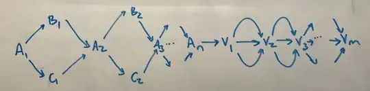

Suppose we have a 3CNF formula $\phi$ with $n$ variables $x_1,\dots,x_n$ and $m$ clauses. We'll have $2n$ keys (one for each $x_i$ and one for its negation, $\neg x_i$). The graph is a sequence of $n$ diamonds, one for each variable, followed by a sequence of $m$ vertices, one for each clause, like this:
Basic graph

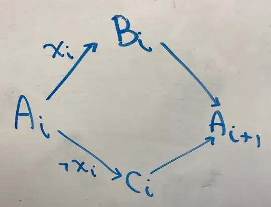

I haven't shown the edge decorations or locations yet. Let's start with the $i$th diamond (corresponding to the $i$th variable, $x_i$):
The edge $A_i \to B_i$ is decorated with the key $x_i$, and the edge $A_i \to C_i$ is decorated with the key $\neg x_i$. There is one location associated with $A_i$; $B_i$ and $C_i$ have no locations. Notice how this forces any valid placement to put either $x_i$ or $\neg x_i$ into the location at $A_i$, and in particular, we can either place the key $x_i$ somewhere or place the key $\neg x_i$ somewhere.

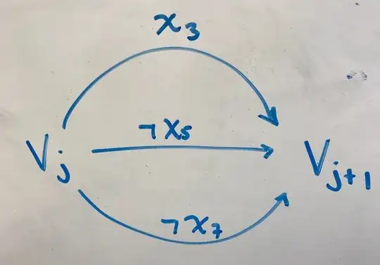

Next, let's look at one of the pieces of the right half of the graph, corresponding to the $j$th clause.:
I've shown the decorations we'd get if the clause is $(x_3 \lor \neg x_5 \lor \neg x_7)$.
Finally, we add $n$ more isolated vertices $D_1,\dots,D_n$ (not shown above), each with a single location. The idea is that the keys that aren't placed into $A_1,\dots,A_n$ will be placed in $D_1,\dots,D_n$, so each key can be placed in exactly one location.
Note that $V_m$ will be reachable if and only if there exists an assignment that satisfies the formula $x_i$.
