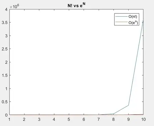

My professor said exponentials will always have higher time complexity compared to polynomials. My question is, do exponentials also have higher time complexity than factorials?
I plotted a chart in Matlab to check it myself.
When range of x is small, from 1 to 10, I get the following chart,
%Matlab script
x  = [1 : 10];
y1 = factorial(x);
y2 = exp(x);
plot(x', [y1',y2']);
title("N! vs e^N");
legend("O(n!)", "O(e^n)");
enter image description here Here factorial is clearly beating exponential.

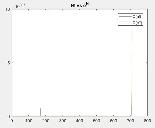

But when I bump the range of x from 1 to 1000, I get the following chart,
x  = [1 : 1000];
Here exponential is clearly beating factorial.
So, can I say conclusively that exponentials will always have higher time complexity than both factorials and polynomials?

In fact $e^n$ is $o(n!)$. We could show it using the Stirling approximation by taking limit $$\lim_{n\rightarrow \infty}{\frac{e^n}{(\sqrt{2\pi n})(\frac{n}{e})^n}} = \lim_{n\rightarrow \infty}{\frac{e^{2n}}{(\sqrt{2\pi n})n^n}} = \lim_{n\rightarrow \infty}{\frac{1}{\sqrt{2\pi n}}\frac{e^{2n}}{n^n}}$$
Since $\lim_{n\rightarrow \infty}{\frac{1}{\sqrt{2\pi n}}} = 0$ we only need to calculate $$\lim_{n\rightarrow \infty}{\left(\frac{e^2}{n}\right)^n}$$ The function $\frac{e^2}{n}$ decreases faster than any function $c^n$ where $0 < c < 1$ for sufficiently large $n$s (as $n$ goes to infinity), and so $\lim_{n\rightarrow \infty}{\left(\frac{e^2}{n}\right)^n} = 0$.

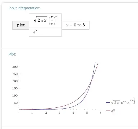

Regarding Quazi Irfan's comments about Matlab graph
I am not a Matlab user, but these are plots for $e^x$ and Stirling approximations of $n!$ using Wolfram script: plot (1\sqrt(2*pi*x)*(x/e)^x) from 0 to 6, plot(e^x) from 0 to 6 enter image description here
As you see $n!$ overtakes $e^n$ when $n=6$.
