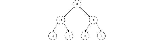

For example, let's say we have a tree of size $n = 7$. It will look like the following:
BST
