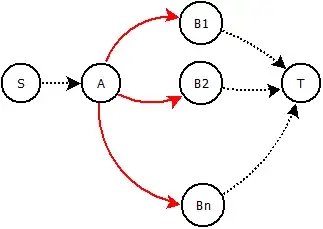

I am currently solving a set of different (assignment) problems by modeling flow networks and running a min-cost-max-flow algorithm. Flow networks are quite handy because a lot of problems can be reduced to them in an easy and understandable way. In my case these are matchings with some additional constraints. As these constraints are getting more complex I've been wondering if there are some existing constructions to model specific behaviors.
In this case I want to restrict the outgoing flow of a node to a single edge.
Given a graph $G=(V, E)$, integral capacities $c(u,v)$ and costs $k(u,v)$. An arbitrary node is called $A$. It's direct neighbors are called $B_1, ..B_n$. Can we replace the edges $AB_1,...AB_n$ (red) with some construction so that only one edge can receive flow? Which means that if $AB_1$ gets some flow (e.g. $5/10$) no other (red) edge can receive flow.
We could add intermediate nodes/edges and play with costs and capacities. The total capacity of our new construction has to stay the same and the cost of the different alternatives have to stay somehow proportional.
So my questions are:
  1. Are there constructions like this in general? (Any keywords, links, papers)
  2. Can you suggest a solution to my specific problem?

In general, the answer is no. If we put XOR-like restrictions on the out-going edges of a vertex, we can prove that finding a min-cut-max-flow is NP-Hard. The technique is to reduce 3-SAT to it.
Let's assume there are $n$ variables $x_1, x_2, ..., x_n$ in the 3-SAT and $m$ clauses $c_1, c_2, ..., c_m$. We create a graph $G(V,E)$ encoding the instance of the 3-SAT problem. For each variable $x_i$, we create a vertex $v_i$ connected to the source $s$ with an edge of $\infty$ capacity. Two more vertices $u_i, w_i$, which are connected to $v_i$, are created to represent $x_i$ taking the value 0 or 1 also with edges of capacity $\infty$.
For each of the clauses $c_i$, we create a vertex $o_i \in G$ corresponding to it and $o_i$ is connected to the variables or their negations in the clause with edges of capacity $1$. For example, if $c_i = (x_3 \lor x_4 \lor \neg x_5)$, we connect it to $u_3, u_4, w_5$ with edges of capacity. All $o_i$ are connected to the sink with edges of capacity 1.
Since $x_i$ and $\neg x_i$ cannot take the same value, we put the XOR restriction on edges $(v_i, u_i)$, $(v_i, w_i)$, $\forall i = 1,2,3,...,n$. It can be proved that there is a maximum flow of size $m$ if and only if the 3-SAT instance is satisfiable. Since the problem is trivially in $NP$ and the reduction is polynomial, we conclude the decision version of XOR restriction network flow is NP-Complete.

For your first question, I do not know any general techniques or rules of thumb that you can use to model arbitrary restrictions in flow networks. Most examples I have seen are generally based on some intuition about the nature of restrictions, and often at first seem arbitrary.
For your particular case, I have yet to come up with a good mapping to max-flow. However, I can suggest a simple alternative solution (you might have already figured that out): Depth First Search from source $s$.
As the flow is restricted to only one outgoing edge for every vertex, what you have is a path from the source to the target. This path satisfies the two properties that it can carry the maximum flow among any other paths from source $s$ to target $t$, and that it has the lowest cost among all such paths that could carry the same flow from $s$ to $t$.

To build on Paresh's answer, if all the max capacities are one (and everything else is integer), you could also split each node into two so that node (n-) has all the in edges, node (n+) has all the out edges, and (n-) and (n+) are connected with an edge of max capacity 1. Solve this new min-cost network and you are done.
If the max capacities are not all one, then the problem is harder. You can formulate the problem as a MIP (Mixed Integer Program). The only integer constraints are the XOR constraints.
Fortunately, these can be modeled as Special Ordered Sets - type SOS1 (see http://en.wikipedia.org/wiki/Special_ordered_set). Most MIP solvers specifically represent SOS1 constraints and will handle them much more efficiently (sometimes you need to tell it, sometimes it will figure it out - check your solver docs).
