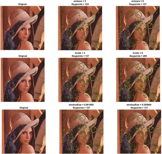

This is what I get by editing the number of octave, layers, and window size (called also sigma0, if I have correctly understood the APIs).
What I see is that by increasing the number of octaves, it increases the number of features and adds larger features.
By increasing the number of levels, it seems to me the same thing happens when the octaves increase, ie the number of features increases and these are larger.
What should happen to the increasing number of octaves? Does it mean that increasing the series of halved images and hence? While increasing the number of levels means increasing the number of DoGs and hence in practice?
Instead, the features don't change varying sigma0, why? As the sigma0 increases, it should increase the degree of blur of the image and hence I should get fewer features, right? I have tried with many values and with different images and I always get the same features.
