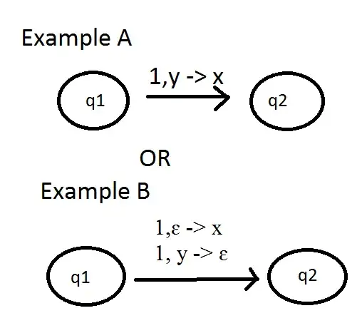

I so far assume that when a string of 11s occur add x to the stack and when 010s add y to the stack, but I'm having issues drawing that part out the part were you check to see if the number of x's in the stack is greater then the number of y's.
Update based on GoodDeeds answer, just need to clearify something Basic PDA Input, Pop -> Push
"Whenever a 11 is encountered, and the top of the stack is not a y, push an x. Else, pop a y."
So in this case whenever a 11 is encountered do I draw out the transition like example A or B?

As you suggested, use the states of the PDA to check when a $11$ or a $010$ has been found. Then, instead of keeping track of the number of $11$s and $010$s separately, keep track of the difference in their numbers.
You could have some symbol in the stack initially, say, $\$$, to mark that the stack is empty. Then, use a symbol $x$ to denote $+1$ in the difference, and $y$ to denote $-1$ in the difference.
Whenever a $11$ is encountered, and the top of the stack is not a $y$, push an $x$. Else, pop a $y$.
When a $010$ is encountered, if the top of the stack is not an $x$, push a $y$. Else, pop an $x$.
Thus, at any given point, the stack consists entirely of $x$s or entirely of $y$s, or only the $\$$. The number of $x$s denotes how many more $11$s have been encountered as compared to the number of $010$s, and vice-versa.
At the end of the input, accept if the top symbol is an $x$, as this would mean that the number of $11$s were more than the number of $010$s.
