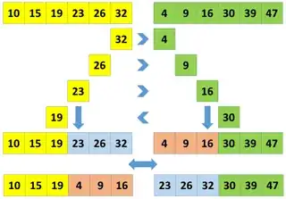

I have trouble analyzing the characteristics of this algorithm that merges two adjacent sorted lists. Basically it looks at some number of the tail of the first list, and the same number of head elements of the second list, swaps them, and recurses on the four sublists. Code for the algorithm:

    // Find tail section of first list
    // and head section of second list
    int left = mid - 1;
    int right = mid;
    while (start <= left && right < end
            && array[left] > array[right]) {
        left--;
        right++;
    // Swap elements
    int n = right - mid;
    for (int i = 0; i < n; i++) {
        int j = mid - n + i;
        int k = mid + i;
        int temp = array[j];
        array[j] = array[k];
        array[k] = temp;
    // Recurse on two pairs of sorted sublists
    merge(array, start, left + 1, mid);
    merge(array, mid, right, end);
An actual implementation can be found here.
So far I was able to establish these points:
  • The recursive algorithm terminates, and correctly merges two lists.
  • In the worst case when merging two lists that are $n$ elements each, there could be $O(n)$ recursion depth. For example, when merging [0, 1, 2, 3, 4, 5, 6, 7, 8, 9] and [0, 10, 11, 12, 13, 14, 15, 16, 17, 18], the 9 swaps with 0 and then recurses. Due to the stack space usage, it is clear that the algorithm is not "in-place" as hoped.
  • If both initial lists have roughly the same distribution (and are "balanced"), then we can expect the merge recursion depth to be $O(\log n)$ which is good.

This algorithm has been previously published in literature; for a detailed worst-case runtime analysis, see [1], [2], and [3]. It is referred to as "Symmerge" or "merging by decomposition". When the two subarrays to be merged are both of length $n$, the algorithm runs in worst-case $O(n \log n)$-time and uses $O(\log n)$ space (due to recursion).
If we use this algorithm for mergesort, the overall mergesort recurrence becomes $T(n)=2T(n/2)+O(n\log n)$; using the Extended master theorem, we know $T(n)=O(n \log^2 n)$.
