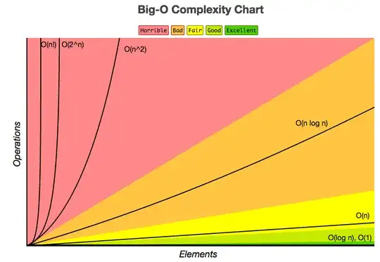

n versus resource consumption

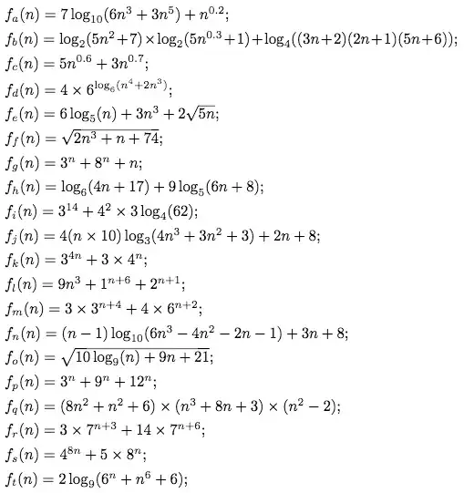

Here are a few more examples of functions often taken as objects of asymptotic analysis in Computer Science:
A few examples of functions often taken as objects of asymptotic analysis in Computer Science
While they can not all be reduced to polynomials, they are essentially sums of terms. Each term may or may not have a constant in its base or exponent. Each term may or may not have a base or constant whose value is determined by $n$.
