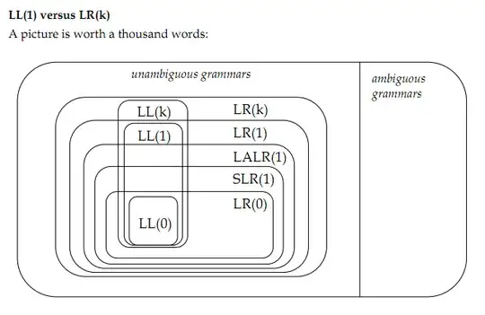

  • Using a top-down translation scheme, we can implement any $LL$-attributed definition based on $LL(1)$ grammar.
  • Using a bottom-up translation scheme, we can also implement any $LL$-attributed definition based on $LL(1)$ grammar (each $LL(1)$ grammar is also an $LR(1)$ grammar). Using bottom-up translation scheme, we implement $LR$ grammar actually but since $LL(1) \subset LR(1)$ we can safely implement $LL(1)$ grammar as well. enter image description here
Mr. Sigma.
  • 1,301
  • 16
  • 38
LL Means Left read and Left derived and LR is Left read and Right derived the left and right part generally makes the difference between how the parser is written and if it top down or bottom up parsing.
