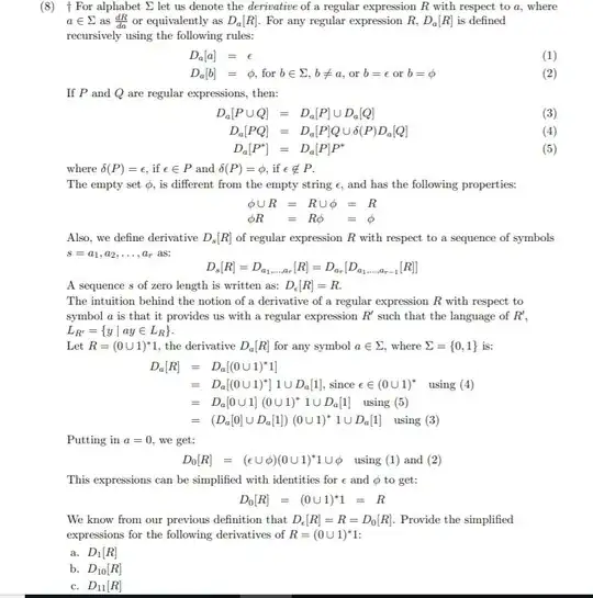

can anybody help me on this
From the definition above also know that . Provide the simplified expressions [R]D ε = R for the following derivatives of : 0 ) 1R = ( +1 * A. [R] D1 B. [R] D10 C. [R] D11
