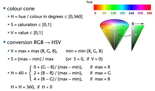

I was trying to implement an algorithm that converts HSV colors to the corresponding RGB ones, and I managed to do it based on the following algorithm provided by Wikipedia. (I'm reporting the whole related text).

Before wanting to find a way to convert HSV colors to RGB Colors, I had already a formula to convert RGB colors to HSV, which I wanted to manipulate to obtain a inverse formula, but I didn't manage to do it.
Here's a picture:
I could show you my attempts, but they are not useful.
Question
  • How is the formula (provided by Wikipedia) to convert a HSV to RGB colors derived from the formula in the picture above to convert RGB to HSV colors?

This comes from the formula to calculate the saturation in your RGB to HSV image above, in which
$$S = (Max(R,G,B) - Min(R,G,B)) / Max(R,G,B)$$
As we just discovered, $V$ is equal to $Max(R,G,B)$, so we can replace it in the previous formula, to arrive at
$$S = (V - Min(R,G,B)) / V$$
Therefore we can find $C$ by multiplying $S$ by $V$, thus eliminating $V$ from the denominator on the right hand side.

Recall that $H$ in the RGB to HSV conversion is calculated differently depending on the max value. There are $3$ ways to calculate it. We also know that the range for $H$ is $[0$ to $360)$.
Therefore each of the $3$ equations must result in a unique range of $120$ values each, as $360 / 3 = 120$
Let's first take a look at the calculation for $H$ when $R$ is the $max$,
$$H = 60 * (0 + (G - B) / (R - min))$$
Assuming that $G$ is larger than $B$, our result will always be positive. If $R = 1$, $G = 1$, and $B = 0$, $min$ would be equal to $B$, and our formula would look like

Okay, that was a whole load of information just to say that we need to convert $H$ back into this "pre-scaled" range of $[-1$ to $5)$, that will be called $H'$. This is done simply enough by $$H' = (H - 360) / 60$$ when $H >= 300$, and $$H' = H / 60$$ when $H < 300$
The variable $H'$ is equal to a value in the range
  • $[-1$ to $1)$ when the $max$ is $R$,
  • $[1$ to $3)$ when the $max$ is $G$,
  • $[3$ to $5)$ when the $max$ is $B$,
Okay, those are all of the intermediary variables we need in order to finally solve for our $R$, $G$, $B$ values.
First, we have to determine what range $H'$ is between in order to know which RGB components we are solving for in each subsequent step.
If $H'$ is in the range $[-1$ to $1)$, then we will be solving for $G$ and $B$. We know from your RGB to HSV conversion that our minimum and maximum values for $H$ are $[-60$ to $60)$ when $R$ is the largest. So, when we divide that range by $60$ to arrive at $H'$, we get the range $[-1$ to $1)$. This also means that
