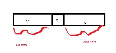

He then draws an array A partitioned around some pivot p. So he draws p, and calls the part of the array that is < p as the 1st part, and the part that is > p is the second part. The length of part 1 = k1, and the length of part 2 is k2. By the correctness proof of the Partition subroutine (proved earlier), the pivot p winds up in the correct position.
By inductive hypothesis: 1st, 2nd parts get sorted correctly by recursive calls. (Using P(K1),P(k2))

In the proof to which you refer, that's exactly what's going on. To use quicksort to sort an array of size $n$, we partition it into three pieces: the first $k$ subarray, the pivot (which will be in its correct place), and the remaining subarray of size $n-k-1$. By the way partition works, every element in the first subarray will be less than or equal to the pivot and every element in the other subarray will be greater than or equal to the pivot, so when we recursively sort the first and last subarrays, we will wind up having sorted the entire array.
We show this is correct by strong induction: since the first subarray has $k<n$ elements, we can assume by induction that it will be correctly sorted. Since the second subarray has $n-k-1<n$ elements, we can assume that it will be correctly sorted. Thus, putting all the pieces together, we will wind up having sorted the array.

The proof is by complete induction on $n$. If $n = 1$ then there is nothing to prove so suppose that $n > 1$. Let $X,x,Y,y$ be as in the procedure Quicksort. Since $x,y < n$, the induction hypothesis shows that $$ X[1] \leq X[2] \leq \cdots \leq X[x] \\ Y[1] \leq Y[2] \leq \cdots \leq Y[y] $$ Moreover, from the way we formed arrays $X$ and $Y$, it follows that $X[x] \leq A[1] < Y[1]$. Thus $$ X[1] \leq \cdots \leq X[x] \leq A[1] < Y[1] \leq \cdots \leq Y[y]. $$ It follows immediately that $B[1] \leq \cdots \leq B[n]$. Thus $P(n)$ holds.

The missing part of the argument is transitivity of '<' - i.e the property that if a < b and b < c, then a < c. The proof that the final array is sorted goes something like this:
Let A[i], A[j] be elements of the array post-sort, where i < j. Then A[i] < A[j] follows from one of the following placement cases (and there are no other cases):
(a) i and j are in the first partition - A[i] < A[j] follows by recursion/induction.
(b) i and j are in the second partition - A[i] < A[j] follows by recursion/induction.
(c) i is in the first partition and j is the index of the pivot - A[i] < A[j] follows by proof of partition procedure.
(c) i is the index of the pivot and j is in the second partition - A[i] < A[j] follows by proof of partition procedure.
(e) i is in first partition and j is in second partition - then by partition procedure, A[i] < pivot, and pivot < A[j]. So by transitivity, A[i] < A[j].
