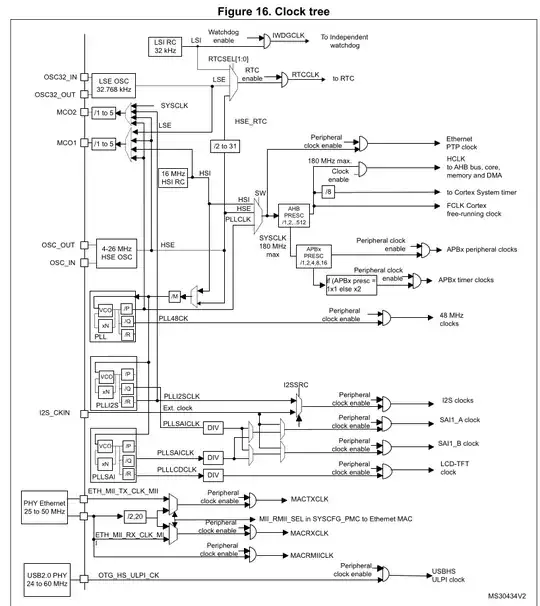

I've attached the clock tree of an STM32F4 microcontroller. This is still not a full "computer" like your PC, but looking at it, you can see, it's a mess. I won't go into much detail on how this works but we can observe some interesting things. STM32F4 Clock Tree
The squares on the left represent pyhsical Pins on the microcontroller's package and are used to get clocks in and out of the system. So we can see, that this specific microcontroller which is not bigger than a coin: enter image description here
already has teh follwoing clock sources:
  1. LSE OSC 32.768 kHz. An externally provided clock for real time clock applications
  2. HSE OSC 4-26 MHz An externally provided clock which is used to derive most clocks in the system
  3. I2S_CKIN A special clock for the Audio part of the system. Audio application require specific frequencies due to precision reasons or weird sample rates like 44.1 kHz which are not easily dividable from other clocks
  4. Ethernet PHY. Most Ethernet applications require a good 100 / 50 / 25 MHz clock
  5. USB Phy. Clock for the USB system
  6. LSI OSC. An internal 32.768 lHz osciallator
  7. HSI OSC. An internal oscillator to provice 16 MHz
Compared to a whole PC, this system is rather small and easy. It is just this small single chip. But it already hass 7 different primary clock sources that "generate clocks out of the blue". Either externally provided, or internally generated.
Usually on-chip clock sources have the advantage of being cheap (no external stuff required) and being available very early on system start. But most ways of generating clocks on a chip are not very precise. Many of these clocks have high temperature drifts and large manufacturing spread. So if a precise clock is required, most chips require an external clock to be provided from e.g. a crystal oscillator that derives its output from the machanical oscillation of an actual crystal.
This is the reason why this chip e.g. has an internal 16 MHz oscillator but also provides a way to feed an external Oscillator. If precision is of secondary concern the internal one can be used to optimize for cost.
Looking further into this system, we can see, that the clock inputs are spread all over the place. I want to move your attention to the PLL blocks. A PLL (Phase Locked Loop) is essentially a fancy way to generate a clock signal dependent on a reference clock. And the fancy thing is, that the generated output clock can have a different frequency than the reference clock. I won't go into details on how this works. There's plenty of explaination on the net on this topic.
So a PLL is a way to generate new clocks based on a reference clock with a specific frequency / pahse relation compared to an reference clock. These PLLs are usally used internally of semiconductors to either achieve variable clocking and/or higher clock frequencies that otherwise would be difficult to route over a board.
Using PLLs and Clock dividers this system uses the input clocks for generating different clocks.
Essentially this system can use a single 16 MHz internal clock generator to provide a 168 MHz CPU clock (via an PLL), an 48 MHz clock for its USB module via another PLL, several lower clocks for its periphjeral modules, like UART, that are divided form the 168 MHz system clock.
As you can see, we only need one clock source to derive several mesochronous clocks from this via PLLs and clock dividers. This is a common practice most moder semiconductors use.
