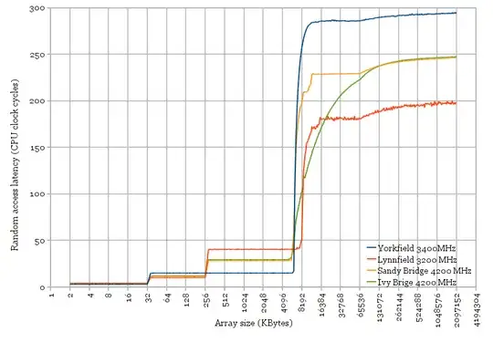

On modern machines, the access times to memory really depends on the number of elements. This effect has an effect much larger than $\log n$, so that relying too much on the idealized computer model is misleading.
