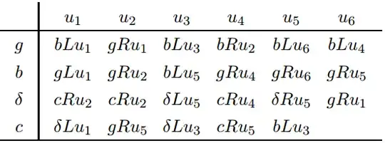

Now that I explained the way to model the work of TM on a CA, let's see why we need 15 symbols. In the paper, the link to which I gave above we have a universal TM $U_{6,4}$ with 6 states and 4 symbols:
So, we need all the alphabet symbols, which is 4, plus all the state symbols which is 6 and all the state symbols $q'$ such that there's a rule $p,x\to q,y,L$, which are $u_1, u_3, u_4, u_5, u_6$, so, we need 15 symbols in total.
So, now there's a gap between 2 and 15 symbols (exclusive), that we don't know about.
