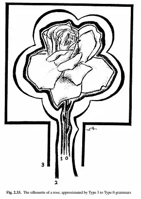

I cannot refrain from asking the same question in the following form. My mind is highly influenced by this description the of grammar type comparison in "Parsing Techniques: A Practical Guide"
Type n grammars are more powerful than Type n+1 grammars, for n = 0,1,2”, and one often reads statements like “A regular (Type 3) grammar is not powerful enough to match parentheses”. It means that more powerful grammars can define more complicated boundaries between correct and incorrect sentences. Some boundaries are so fine that they cannot be described by any grammar (that is, by any generative process). This idea has been depicted metaphorically in Figure 2.33, in which a rose is approximated by increasingly finer outlines. In this metaphor, the rose corresponds to the language (imagine the sentences of the language as molecules in the rose); the grammar serves to delineate its silhouette. A regular grammar only allows us straight horizontal and vertical line segments to describe the flower; the result is a coarse and mechanical-looking picture. A CF grammar would approximate the outline by straight lines at any angle and by circle segments. The result is stilted but recognizable. A CS grammar would present us with a smooth curve tightly enveloping the flower, but the curve is too smooth: it cannot follow all the sharp turns, and it deviates slightly at complicated points; still, a very realistic picture results. An unrestricted phrase structure grammar can represent the outline perfectly. The rose itself cannot be caught in a finite description; its essence remains forever out of our reach.
