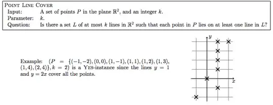

This can be seen as a special case of set cover. All points (each p belongs to P) are in a cartesian plane, and the algorithm needs to find if they can be covered by k lines (where each line l belongs to L). This image below clarifies it further:
Point-line-cover
My question is around what is written in the paper linked above at page 666 regarding where is p taken from: At some point during the text it says "Otherwise, the algorithm chooses an element p ∈ S'". However, further down in the algorithm it says "choose p ∈ S" (without the prime symbol).
Is p taken from S or S' (S prime)?
Thanks!

The algorithm should say "choose $p \in S'$", that is, the text is the correct version, rather than the pseudocode.
Note how the algorithm works:
  • $S',S_{1},\ldots,S_{k}$ form a partition of $S$ (i.e. every element of $S$ is in exactly one of $S',S_{1},\ldots,S_{k}$).
  • At each step it chooses which $S_{i}$ to put $p$ into.
  • Initially $S' = S$, and $S_{i} = \emptyset$ for all $i$.
So $S'$ is the set of points that still need to be covered, and $S_{i}$ is the set of points covering by hyperplane $i$, in some abstract sense. Thus the algorithm, at each iteration, picks an uncovered element from $S'$, and puts it in some $S_{i}$.
