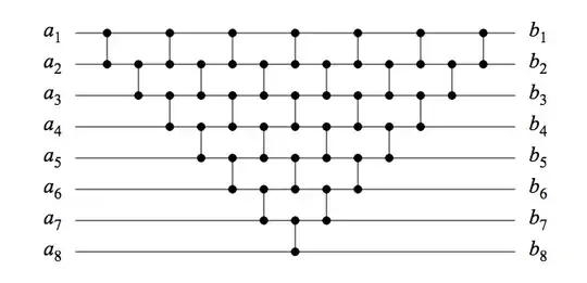

I am presented with a comparison network. How can I determine if the comparison network is a sorting network? In the image below there is an example of a selection sort and insertion sort network. The intent is to have a comparison network and sort numeric values. If I test 2^n values in this case 2^8. This is a lot of work|non-efficient way to test it. I'm looking for a mathematical model/proof to verify this is a valid sorting network. A sorting network based on insertion sort

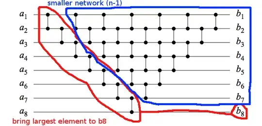

While D.W.'s (excellent) answer deals with the general case, I will consider your specific example. A network of this form with $n$ inputs can be shown to be a sorting network by induction: (see image for illustration)
  1. $n=1$ input is always sorted;
  2. Assume that a network of size $n-1$ of this form is a sorting network, and consider a network of size $n$.
    1. The left-most "diagonal" will always correctly bring the largest element to the $n$-th position (in your case, $b_8$);
    2. You are left with a smaller, similar network with the remaining $n-1$ elements;
    3. This smaller network will sort all the remaining elements by the inductive hypothesis.
Proof illustration
