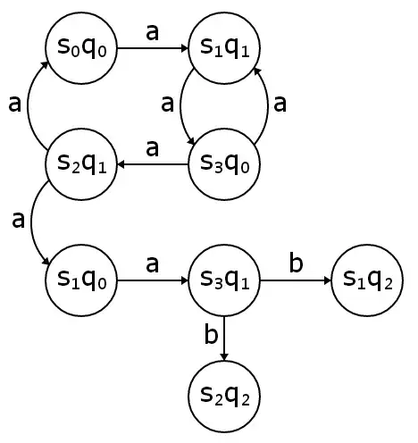

Dealing with a question that asks me to compute the product of the following transition system and finite automaton.

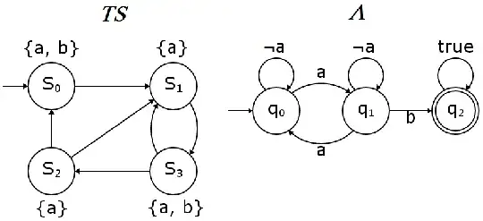

Compute the product between the transition system TS and the finite-word automaton A depicted below.
Task graphics
Can't seem to find a good example on how to do this so I sort of just freestyled my answer. The best I found was in Principles of Model Checking but the book didn't really explain how the product was derived (it just provided a TS, FA and product), so I had to "guess" the logic.
Can anybody have a quick look at my solution and see if there are there any obvious mistakes I have made?
Solution attempt
Also I can't figure out whether or not I should indicate any terminal states. I know that a TS doesn't have any terminal states, but an FA can - so what about the product?

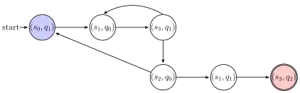

Based on the definition above, I calculate the product as follows (please check it):
product
  • For what it concerns the terminal states, please refer to "Remark 4.17" (immediately following the Definition above) in the book.
  • By the way, the labels for transitions (action denoted by $\alpha$ above) in $TS$ are often ignored (because they are irrelevant).
