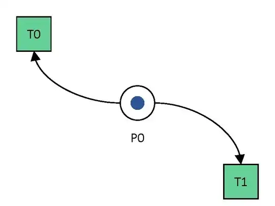

How many transitions fire at once depends on the interpretation assigned to the Petri Net.
If you want more than one transition to fire at once, you should consider:
1. Will the transitions fire using one processor?
This is fine. A Petri Net can handle this type of firing because the transitions actually fire one at a time. Consider the Petri Net in the following diagram:
Let m0 be the mark in place P0. Consider the firing rule for T1: m0 = m0 - 1,and the firing rule for T2: m0 = m - 1. It is easy to check if a transition is enabled before firing the transition.
2. Will each of the transition to fire use a different processor?
This is probably not fine. Using the same example above, consider a processor is responsible for firing T0 and another processor is responsible for firing T2. Each processor checks if its transition is enabled. If it is enabled, the processor fires the transition. Each check may indicate that the transition is enabled. So each processor will proceed to fire the transition. Depending on when each processor reads m0 and writes the computed value of m0, the value of m0 may be 0 or -1.
