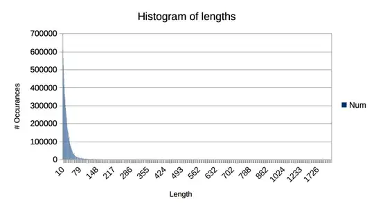

where $p$ was chosen as follows: I counted how many lines of a given length $l$ appear (say $n_l$), for lines of length $l$ I chose $p$ s.t $$\frac{n_l}{p^2}\leq 3$$
the following is a Histogram showing $n_l$ as a function of $l$
which should give some indication of the values chosen for $p$.

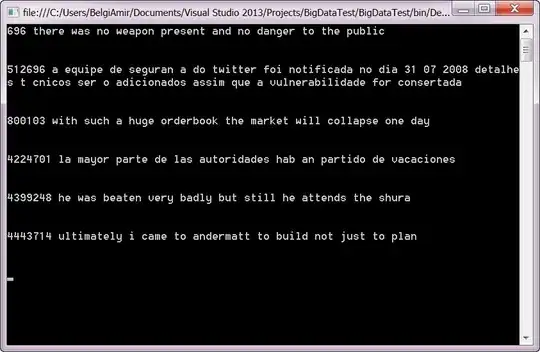

I took one example of such a bucket and I printed those sentences (I hoped they are similar so they would have a good reason to be mapped to the same bucket) by they are very different from one another. This is a printscreen of those sentences printed to the console.enter image description here
Question: Why do I get a large number of collisions ?($6$ in average on $10^5$ buckets I considered where if I had even distribution I would expect $3$ from the choice of $p$, some buckets have a few tens of elements in them)
