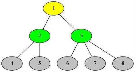

My problem is how to find a structure that would fulfill the suppositions about size as well as having an independent neighborhood? It's all roses when every vertex in $I$ is of the same degree, e.g. ($I$ is yellow, $N(I)$ is green):
Degree 2

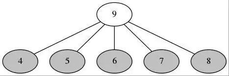

which reduces to
Reduced 2

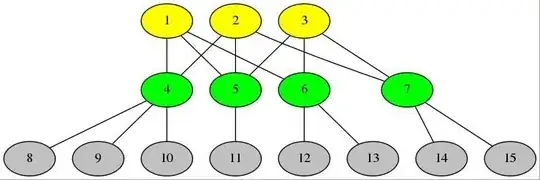

Degree 3

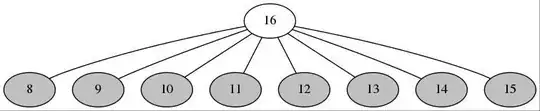

which reduces to
enter image description here.

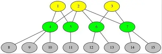

But unfortunately this reduction may apply to a set of vertices of differing degrees. An example:
2-4-2
note the different edges between yellow and green. It also reduces to:
2-4-2 reduced
What baffles me is what would the algorithm for that be, since the paper states that given a maximum size $k$ of a vertex cover existing in the graph, it is possible to be done in $O(k^{2}\sqrt{k})$.
