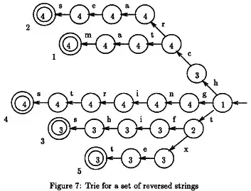

This is where my problem lies. As I said, the algorithm goes through the text and check if it contains a word from the set of keywords. The words are arranged upside down and placed in a tree. To be efficient, it will sometimes be necessary to skip a number of letters, when he knows that there is no match found.
Trie
To determine the number of characters that can be skipped, two tables d and dd have to be computed. Then, the algorithm is very simple:

  • We align the root of the trie with position m in the text, and we start matching the text from right to left following the corresponding path in the trie.
  • If a match is found (final node), we output the index of the corresponding string.
  • After a match or mismatch, we move the trie further in the text using the maximum of the shift associated to the current node (means dd), and the value of d[x], where x is the character in the text corresponding to the root of the trie.
  • Start matching the trie again from right to left in the new position.

$p_i$ is a word among the set of keyword, $j$ is the index of a letter in this word, so $p_i[j]$ is like a node in the previous trie I showed. Number in the node represented $dd(node)$. $L$ is the number of words, and $m_i$ is the number of letters in the word $p_i$.
