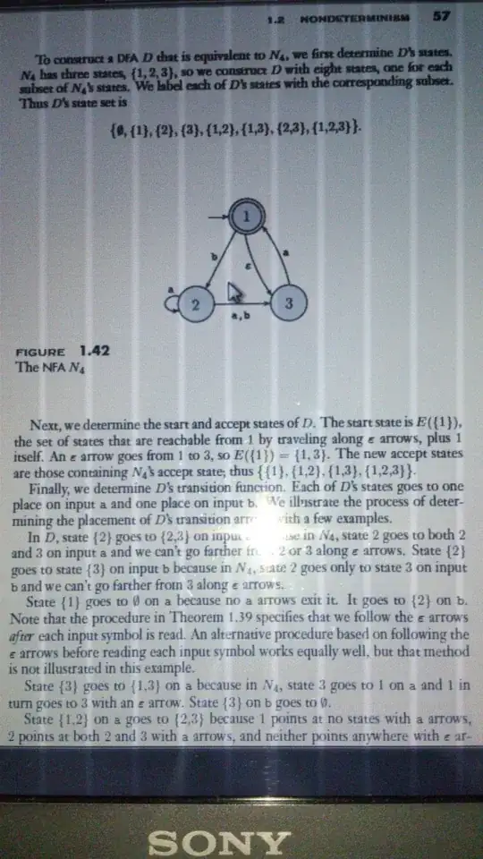

Before asking this question,I had gone through Equivalence of NFA and DFA - proof by construction
but my question is a bit different from that. I was reading Michael Sipser's Introduction to Theory of Computation and I came to a problem. I couldn't understand as to how he is taking his act on equivalence between NFA and DFA.
I have problem understanding this para :-
Next, we determine the start and accept states of D. The start state is E({1}), the set of states that are reachable from 1 by traveling along ε arrows, plus 1 itself. An ε arrow goes from 1 to 3, so E({1}) = {1, 3}. The new accept states are those containing N4’s accept state; thus {1}, {1,2}, {1,3}, {1,2,3}.
My assumption---> As {2} is not in the list of accepted states,so {1,2} should not be considered as new accept state in equivalent DFA.Also,{1} and {1,2,3} and {1,3} stand out as new accept states as per me because traversing from 1 to reasonable nodes lets the final accept state be reached---here,{1},accept state--->{1,3}---accept state as on inputting a from node 3 makes arrive at {1} which is an accept state,hence accpeted,and similarly for {1,2,3}.
So,point at my wrong thinking PLEASE. I have understood that while making transitions only those states are considered final states which are accept states in NFA.Am I wrong???So,how come {1,2} be the new accept state in the equivalent DFA?
Secondly, why he has mentioned that
The start state is E({1}), the set of states that are reachable from 1 by traveling along ε arrows, plus 1 itself`.
I couldn't derive a meaning out of this statement,the reason might be my poor understanding of English language(I am non-native English speaker).Means start state is E({1})---fine upto here. Now, the set of states that are reachable from 1 by travelling along ε arrows,plus 1 itself---It doesn't make any meaning standing as an independent sentence. Someone make me understand the meaning of this line,PLEASE!
Someone please make me understand and elaborate a bit. I feel that author might be wrong there,pardon my noobiness or for any mistake!

Motivation. In this construction, the intent is to make a DFA equivalent to a given NFA. In the original NFA, look at what happens when we're in state 2 and we see input $a$: we could either stay in state 2 or make a transition to state 3. If we want to eliminate nondeterminism, we could say that from state 2 looking at input $a$ we move to the single new state $\{2,3\}$, meaning that in this case, we're either in state 2 or state 3. In other words, in the constructed DFA we'll have the transition $\delta'(\{2\}, a)=\{2, 3\}$. The important thing to notice is that this transition in the new FA is deterministic: from the state $\{2\}$ on reading $a$ we move to the single state denoted by $\{2, 3\}$. Guided by this convention, we will build the DFA by defining the states to be all possible sets over 1, 2, 3, namely $$ \emptyset, \{1\}, \{2\},\{3\}, \{1, 2\}, \{1, 3\}, \{2, 3\}, \{1, 2, 3\} $$
Final States. Let's start with an example: what does the NFA do on input $baa$? We'll have, in order
  1. In state 1, looking at $b$. Go to state 2.
  2. In state 2, looking at $a$. Go to state 2 or state 3.
  3. Looking at the last input, $a$ we could be in either state 2 or state 3. If we're in state 2, go to state 2 or state 3 as before. If we're in state 3, go to state 1.
In other words, at this stage, after having read $baa$ we could find ourself in states 2, 3, or 1.
In the DFA, we have, equivalently, the transitions $\delta'$ defined as
  1. $\delta'(\{1\}, b) = \{2\}$.
  2. $\delta'(\{2\},a) = \{2, 3\}$.
  3. $\delta'(\{2, 3\}, a) = \delta'(\{2\},a)\cup\delta'(\{3\},a) = \{2, 3\}\cup\{1\}=\{1, 2, 3\}$.
Now the question is, should state $\{1, 2, 3\}$ be considered as a final state? Sure, since the NFA, reading $baa$ has at lest one possible collection of transitions that leads to the accepting state 1. In a similar way, any state of the DFA containing 1 will be a final state, so in the DFA there will be four final states: $$ \{1\}, \{1, 2\}, \{1, 3\}, \{1, 2, 3\} $$ Now it turns out that in the DFA the state $\{1,2\}$ is never used, but that doesn't negate the fact that it's a final state (since it contains 1). All it means is that there is no transition that takes you there. It's what we call an unreachable state. This, I hope, answers your first question.
Start State. This answer to your first question has little to do with the answer to your second question. The answer for your second question is: just as we did to determine the final states of $D$, we also need to know what the start state of $D$ is, and in this case it will be the set of states containing the start state of $N_4$, along with any other states that can be reached from that start state via $\epsilon$-moves, namely $\{1, 3\}$ (which of course will also be a final state, though that's not important here).

The following is an attempt at explaining informally the idea of the construction. There are other ways to look at it, somewhat more theoretical. I do not know how Sipser precisely does it.
The principle of the construction of the DFA $D$ from the NFA $N_4$ is that, for a given input, the DFA $D$ simulates all the computations that $N_4$ could follow depending on non-deterministic choices it permits. In other words, for an input string $w$, $D$ will reach a state, which is precisely the set of all states that $N_4$ could reach for some computation with that same input $w$. That is why a state of $D$ is a set of states of $N_4$.
For the start state, the situation is the same. For a DFA, the start state is the state you are in when you have not read any input, or to say it differently, the state you are in after reading the input $\epsilon$. For a NFA, it is possible to reach other states from the start state without reading anything, if it has an $\epsilon$-transition to them.
In the case of $N_4$, you have $1$ as start state. But without reading anything, you have a transition to state $3$. Hence states $1$ and $3$ can both be reached by reading $\epsilon$, i.e. nothing at all. This is why the set $\{1,3\}$ is the start state of $D$. It means that $N_4$ can be (non-deterministically) in state $1$ or in state $3$ before reading any input, and in no other state.
This must remain true for all other states of $D$ (which are sets of states of $N_4$). The DFA $D$ reaches state $S$ after reading string $w$ if and only if, for each $N_4$ state $q$ in $S$, there is at least one computation of $N_4$ that reaches state $q$ when reading $w$. That is what the construction does.
Then, if a state $S$ of $D$ contains a state $q$ of $N_4$ which is an accept state, it means that for any input string $w$ that brings $D$ in state $S$, there is at least one computation of $N_4$ on input $w$ that brings $N_4$ into state $q$, and hence accepts the string $w$.
Since $D$ is supposed to accepts all the strings accepted by $N_4$, it follows that $S$ must be an accept state of $D$. There is no other way to accept the string $w$ since $D$ is deterministic by construction.
Hence, any state $S$ of $D$ that contains an accept state of $N_4$ has to be an accept state for $D$. Since $1$ is the only accept state for $N_4$, the set $\{1,2\}$ has to be an accept state of $D$.
First question
First I must say I cannot understand what you are saying in the paragraph that starts with:
My assumption---> As {2} is not in the list of accepted states ...
To begin with, as I said in a comment, you do not have lists of states, only sets of states. Second, you should talk of accept states, or accepting states, but not of accepted states.
Also, there are no new states, but only states of $N_4$, and states of $D$ which are sets of states of $N_4$. Accept states of $D$ are precisely those that contain an accept state of $N_4$, for the reasons explained above.
I cannot say much more because I do not understand what you are trying to say, what is in your mind. Why would you consider that $\{1,2\}$ cannot be an accept state of $D$, but that $\{1,2,3\}$ can be an accept state of $D$?
My further attempt to explain
The fact that both $1$ and $2$ are in this set $\{1,2\}$ indicates that there is a string $w$ for which the NFA $N_4$ can reach either $1$ or $2$ depending on non-deterministic choices in the computation. Of course, the computation that reaches state $2$ does not accept $w$. But the definition of acceptance for a non-deterministic machine is that it is enough if one computation accepts $w$, even if all other non-deterministically possible computations on $w$ fail to be accepted. In this case, it is enough that some computation on input $w$ can reach $1$.
Second question
The sentence you do not understand is apparently a problem with English. It should be read as
The start state is E({1}) which is the set of states that are reachable from 1 by traveling along ε arrows, plus 1 itself`.
I think this kind of sentence structure (with a comma instead of "which is") is called an apposition.
