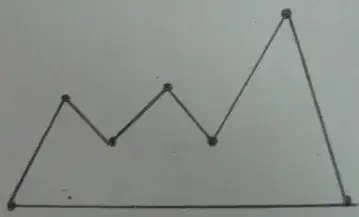

The original polygon $p$:

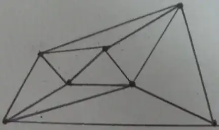

Delaunay triangulation of vertices of $p$:

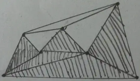

Result of inside/outside test over triangles $t$(Shaded triangles are inside $p$ and rest are outside):

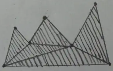

Desired result(pruning outside triangles):
