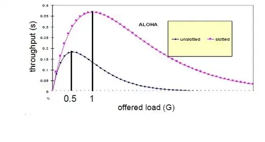

Here's nice graph comparing the two ALOHAs, made by Reuven Cohen.
